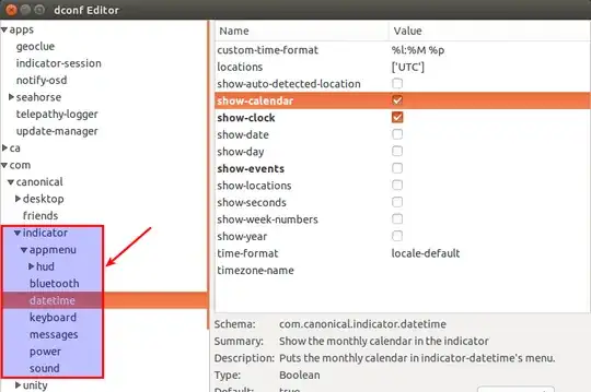

You can use Dconf Editor to disable the notifications. To install dconf editor, just press Ctrl+Alt+T on your keyboard to open Terminal. When it opens, run the command(s) below:
sudo apt-get install dconf-editor
Once installed, type dconf in Dash, and then click on dconf Editor. Once open navigate to com --> canonical --> indicator --> and disable the ones you want.
