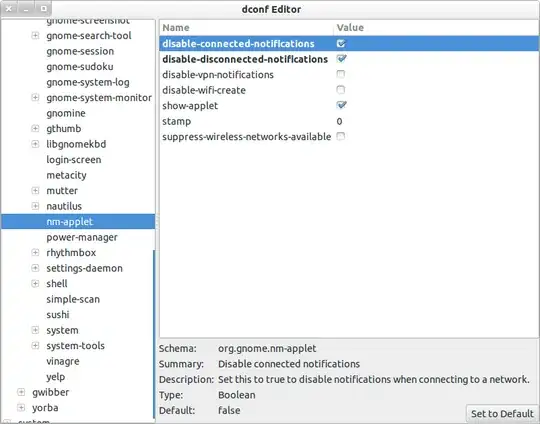

12.10 - Dconf
Run these commands:
gsettings set org.gnome.nm-applet disable-disconnected-notifications "true"
gsettings set org.gnome.nm-applet disable-connected-notifications "true"
Or open dconf-editor and scroll down to orggnomenm-applet and check disable-connected-notifications and disable-disconnected-notifications settings there.
DConf
11.10 and 12.04 - Gconf
Gconf-editor lets you edit the network manager notifications.
To alter these settings, install gconf-editor from the software-center.
Scroll to / ▸ apps ▸ nm-applet and check disable-connected-notifications and disable-disconnected-notifications settings there. Check the attached image for clarifications.

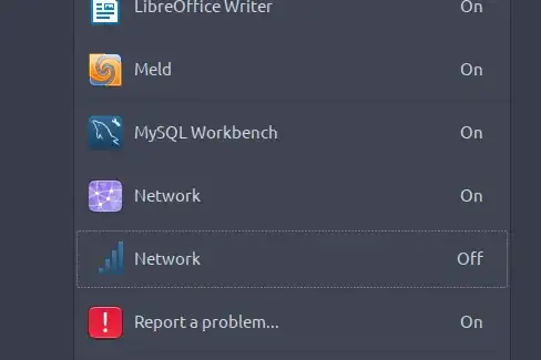

If you are looking for ubuntu 18.10 then you can disable from gnome.
go to network section then
Adiii
