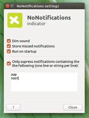

1. Major update
Just finished a completely rewritten version of the indicator (0.9.0). Options now include:
  • suppressing only notifications, containing specific strings
  • suppressing (muting) sound
  • logging missed notifications
  • running on startup
  • remembering the last state (suppressing or not) on next run
Furthermore many, many improvements on interface and behaviour.
Installing is unchanged (ppa):
sudo apt-add-repository  ppa:vlijm/nonotifs
sudo apt-get update
sudo apt-get install nonotifs
