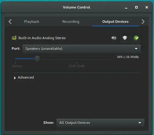

i had same issue after installing 16.06 ubuntu gnome in my dell xps. then i solve this issue by .......
sudo apt-get install pavucontrol
after install pavucontrol. open it by simply typing terminal pavucontrol.
then go to -> Output Devices tab -> change port
in my case seleted port was Headphones(plugged in) by default after plug headphone
change port Headphones(plugged in) to speakers (unavailable).
this is a temporary fix.after rebooting your pc you have to do this again.

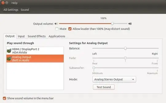

I had the same issue. I did as below
  • Go to Settings
  • Click on Sound settings under hardware section
  • Click output tab (automatically selected by system)
  • On the bottom side: set the output volume to 100%
Thanks to https://superuser.com/questions/357623/headset-is-not-working-with-ubuntu-11-10

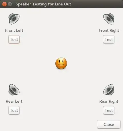

To day I got it in easy way:
How to using headphone in Ubuntu:
  1. Install update for Ubuntu.
  2. Install GNOME alsa mixer.
  3. Plug in both of back speakers and front headphone.
  4. In ALSA: mute your front column, unmute in Headphone.
  5. Go to Sound setting: unmute your sound that was made by ALSA.
  6. Click the Test Sound button to go to Test Sound in Sound settings, check left and right ==> ONLY HEADPHONE has sound, Speaker will be silent.
IMG:
