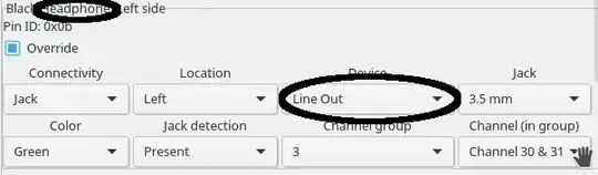

My answer was the same as BcK's answer, except I had to override "headphone" to the "line out" port, see the image below. Everything works perfectly now, thanks Bck!
