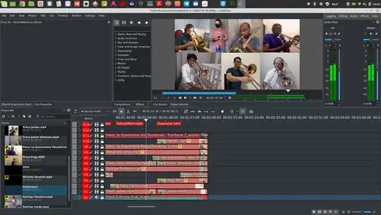

Once I have erased the file (according to KDEnlive online Manual) It came back just fine!! Solved How the crash would appear to me
I hope I have helped
The error Message
[![Problem solved][2]][2]
