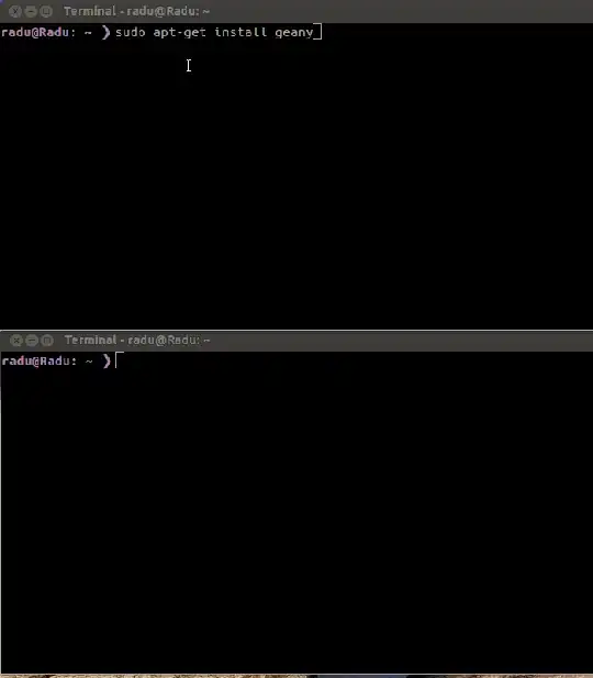

You can make apt-get to learn to wait if another software manager is running. Something similar with the behaviour from the next screen cast:
How I made it?
I create a new script called apt-get (wrapper for apt-get) in /usr/local/sbin directory with the following bash code inside:
#!/bin/bash
i=0 tput sc while fuser /var/lib/dpkg/lock >/dev/null 2>&1 ; do case $(($i % 4)) in 0 ) j="-" ;; 1 ) j="\" ;; 2 ) j="|" ;; 3 ) j="/" ;; esac tput rc echo -en "\r[$j] Waiting for other software managers to finish..." sleep 0.5 ((i=i+1)) done
/usr/bin/apt-get "$@"
Don't forget to make it executable:
sudo chmod +x /usr/local/sbin/apt-get
Before to test, check if everything is ok. The output of which apt-get command should be now /usr/local/sbin/apt-get. The reason is: by default, the /usr/local/sbin directory is placed before /usr/bin directory in user or root PATH.
