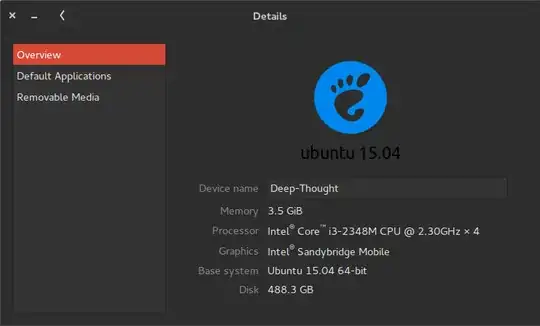

If you want to check it through your desktop environment, you can check System Settings → Details, which shows the data like this:
Display of "System Settings → Details"

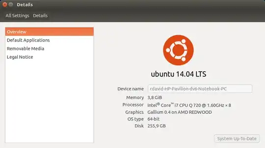

Executing this in Terminal will give you all of the information you could possibly need:
lsb_release -a
And you can access it in the GUI by going System Settings > Details:
