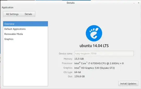

Also, you can head to Settings and look for Details or About This Computer and that can give you details of your distribution.
details
