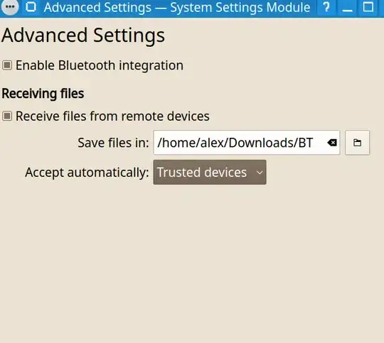

Just in case... My system is XP13/KUbuntu 20.04 recently upgraded from 18.04 and I had a "Receiving files failed".
Appears it was simply because the folder to receive the files had disappeared. Workaround was to recreate the folder.
