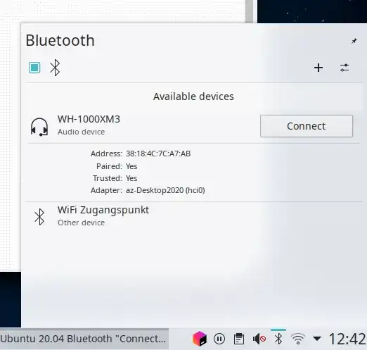

This is to my bluetooth headphone.
screen1

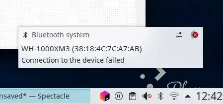

Then I click on "Connect", and after a few seconds, I get this message:
screen2
"Connection to the device failed"
The strange thing is, this has worked previously. There might have been updates in between but I'm not exactly sure.
Also, I was dual booting Windows before, and there Bluetooth with the same headphone works just fine. I recheck by booting in again to Windows, and it still works, but then booting back to Linux, and it does not work.
This sounds related, because some people also report dual boots with Windows. However, the suggestion with reloading btusb (or maybe also btintel) did not help.
