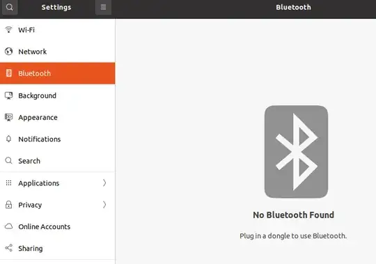

As the title mentioned, Bluetooth is not working and through Settings, I cannot enable it. It seems that Ubuntu could not detect the Bluetooth driver.
printscreen of bluetooth not being detected in "settings"

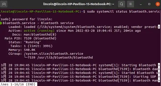

  2. Tried sudo rmmod btusb + sudo modprobe btusb + checking status of Bluetooth with systemctl. Seems to be activated, but again, I cannot switch on my Bluetooth through the Settings
    Showing "Active" status in systemctl for bluetooth
