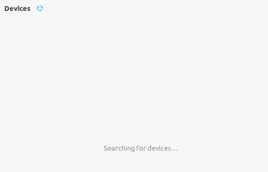

I'm trying to pair my speakers to my computer via Bluetooth. The first thing I do is go to "Settings" and then go to "Bluetooth". Once I enable it my screen looks like this:
I've been waiting several minutes and even though I turned on my cellphone and speakers' Bluetooth, it's still trying to find any devices.
I checked that both my cellphone and speakers' Bluetooth worked by pairing them to each other, and the connection is established correctly.
I tried the first two solutions given in this post but my computer still does not find any device.
Any ideas on how I can fix this issue?
