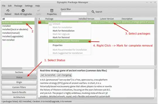

  • Install the Synaptic Package Manager, either through the Software Center or by running this command in the Terminal:
     sudo apt-get install synaptic
  • Open it by typing synaptic in the Unity dash and then hitting Enter.
  • Then follow this procedure:
    1. Select the "Status" category. This shows packages organized by status.
    2. Select "Broken dependencies" category from upper left pane.
    3. Select the broken packages. If the packages are more than one, select them all by pressing Ctrl+A.
    4. Then right-click on a selected package, and select the option "Mark for Complete Removal" in the menu.
    Screenshot showing "Mark for complete removal" on packages with broken dependencies
That's it. The broken packages are gone.
