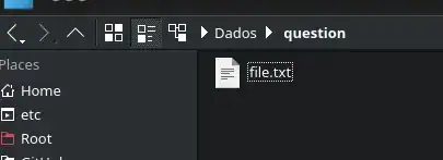

Example
Let's say I have a file called file.txt in a folder and I'm using Dolphin (it works the same for Nemo or Nautilus)
This file content is:
# Hello World File
This is a file with a content, it has any number of lines.
Now let's say I select this file and press Ctrl+C in it, if I try to paste it in a text editor I'll see
file:///home/Dados/question/file.txt

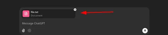

Well, even though it looks like it's just copying the absolute path of the file, it's actually doing something more. Let's say I open the ChatGPT prompt and press Ctrl+V in it:

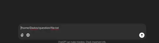

It uploads it there as a file, not the absolute path of the file. That's what I'd like to do... However, using xclip or xsel with:
echo -n "file:///path/to/file.txt" | xclip -selection clipboard
or
printf '/path/to/file.txt' | xclip -sel c
These commands don't work as I expect, if I use them and press Ctrl+V on ChatGPT it'll just paste the absolute path of the file:
