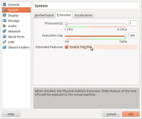

This answer completes existing answers on a bare metal installation with settings needed for an installation in Virtual Box.
Expose PAE to a virtual machine in Virtual Box
The kernel shipped with Ubuntu >= 12.04 is a PAE kernel by default.
From installations in Virtual Box the PAE capability of the CPU (if supported) can be exposed to the virtual machine. Choose "Enable PAE/NX" from the Virtual Box Manager System -> Processor settings:
In case this option is greyed out your host CPU does not have this feature. Only then you will have to install a non-pae kernel.

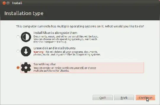

If you need support for non-pae ready systems, try lubuntu. If after installing you decide that you do not like the LXDE environment, you can install unity with this command:
sudo apt-get install ubuntu-desktop
To completely remove, and reinstall ubuntu, choose "Something else", and select the partition with ubuntu currently installed on it to be used as "/", ext4, and check the format box.
