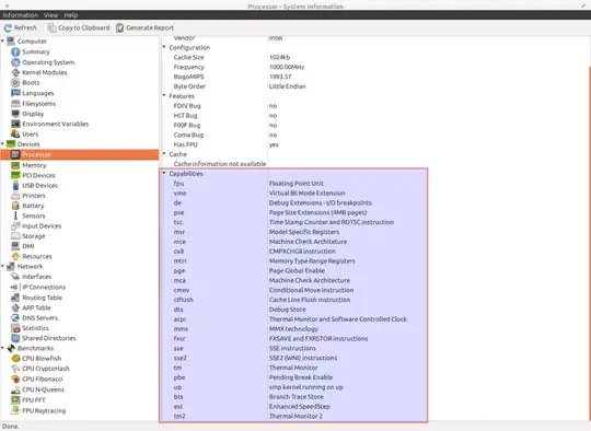

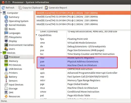

Another option (which uses a GUI) involves using Hardinfo (System Profiler and Benchmark.
  • Under devices, select Processor.
  • From here, you can see the processor's capabilities (along with their simple descriptions).
  • If PAE is not listed, your processor does not support it.
  • As you can tell, the processor in this example does not.
  • and this one does.
