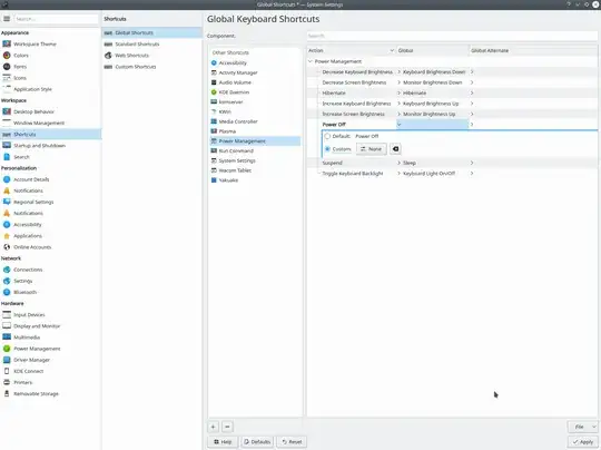

I have recently faced the same issue with keyboard. It has 'Power' and 'Sleep' buttons near F12 key, which I use to toggle yakuake.
I have disabled these buttons via KDE system settings (in Kubuntu 18.04) in Shortcuts > Global Shortcuts > Power Management. Then just changed Global shortcut for 'Power Off', 'Suspend' and 'Hibernate' actions.
I think, the settings path can slightly differ in other version of KDE, or Kubuntu.
Example path to find these settings
