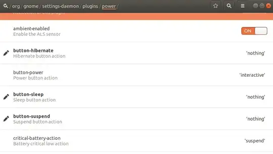

Already tried all solutions from: How do I disable the sleep button on my keyboard?
gsettings set org.gnome.settings-daemon.plugins.power button-suspend "nothing"
gsettings set org.gnome.settings-daemon.plugins.power button-sleep "nothing"
gsettings set org.gnome.settings-daemon.plugins.power button-hibernate "nothing"
and I have now with dconf-tools:

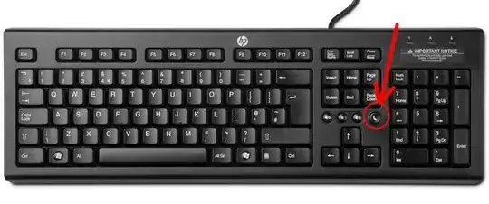

In my case HP Hewlett Packard WZ972AA ABA Classic Keyboard:
This "Moon" button still working.. Any another ideas?
