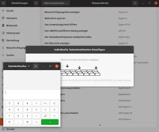

My lenovo Laptop has a short-cut for to open a calculator.
Since I don't use this, I want to use this key for a different action.
But if I try to add a new shortcut, the calculator opens. It seems, I can't create a new shortcut for this key.
change-shortcut-for-calculator

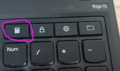

The key which I would like to start my own script:
lenovo-calculator-key
