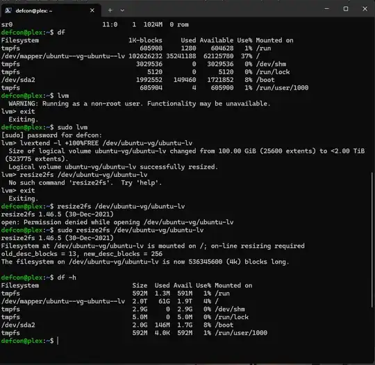

This is still relevant today. Ubuntu 22.04.
Example of fix:
example of fix
It's absolutely ridiculous that this isn't the default behavior. Of course I want my 2TB drive
Commands below for copying and pasting without the failed commands. :)
ssh user@ipaddress
cd ~
df
(Note the drive: /dev/mapper/ubuntu--vg-ubuntu--lv)
Escalate privilages into lvm:
sudo lvm
Run LV Extend:
lvextend -l +100%FREE /dev/ubuntu-vg/ubuntu-lv
Now exit:
exit
Then resize:
sudo resize2fs /dev/ubuntu-vg/ubuntu-lv
New found free space visualized:
df -h
