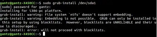

I tried sudo grub-install and it give me this error message.

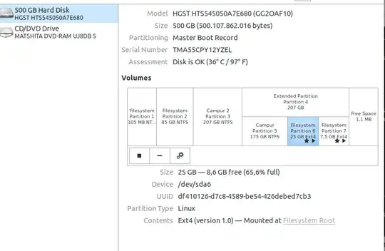

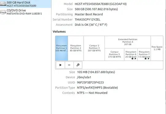

I tried to check if i have chosen the right disk, which come two possibilities, /dev/sda1 and /dev/sda6, but neither of these two works, and they gave the same error message.
/dev/sda1/
/dev/sda6

This assumes that /dev/sda is your disk that matches (hd0,msdos6) in your grub command, which it likely is. You can run a graphical program like gnome-disks or gparted to confirm it's the correct disk.
