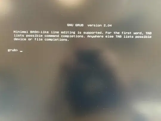

I'm having a problem with a linux/windows dual boot system. If power on the system or do a system restart, my grub menu disappears and I am left just at this Grub screen:

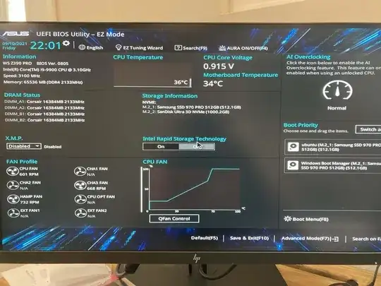

However, if I boot and open the bios....and don't change anything, just exit...It works...
