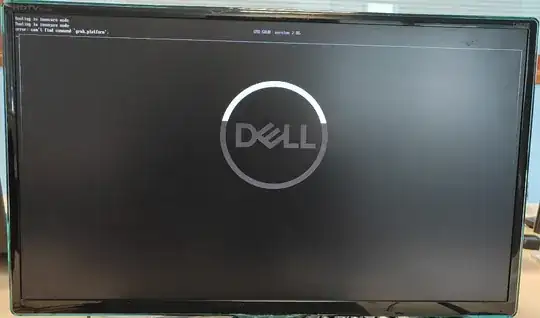

I HAVE DISCOVERED AN ERROR! Before I didn't notice it because it lasts a fraction of a second. But with a video from the phone, which I had to set to 60 fps to be able to catch the error, I recorded it, then took it to the PC, from the PC I took a screenshot of that video fragment, then rotated it and cropped with gimp.
The error is as follows:
error: can't find command `grub_platform`.
Here is the screenshot:
