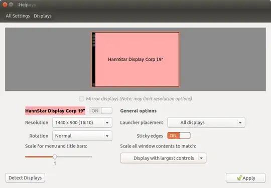

Looks like it is different in 14.04. Done though display settings.
