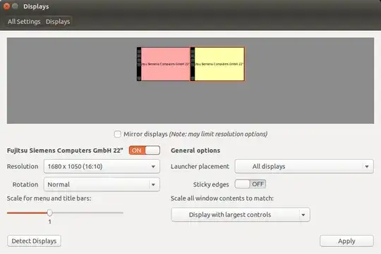

Go to Displays and disable Sticky edges.
screenshot
