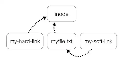

"A picture is worth a thousand words." Pictorial representation
And, "An example is worth a hundred paragraphs..."

Changing the name of blah1 does not matter:
$ mv blah1 blah1-new
$ cat blah1-hard
Cat
blah1-hard points to the inode, the contents, of the file - that wasn't changed.

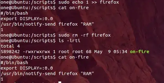

Question: How do I make Hard link?
Answer: A Hard link can be made with ln; first you need to define the source and then you need to define the destination. (Keep it mind you need to define the full path of both source and destination; otherwise it will not work.)
Let's say I have a script in the /script directory named firefox.
 ls -i # Shows you the inode
 5898242 firefox
 ln /scripts/firefox /scripts/on-fire
       ( Source )    ( Destination )
As you can see, it has the same inode. If I delete the original file, the link will still work, and it will act as the original.
Above, I check that the link is working, and then delete the original firefox script.
