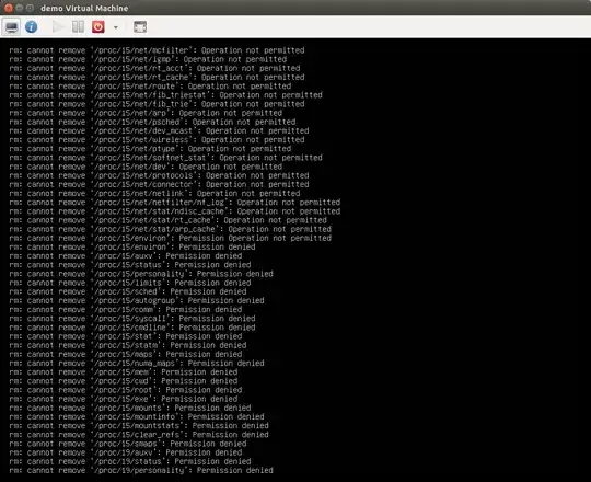

I did. rm -rf / --no-preserve-root was running in a root session opened directly on the machine, while I was also connected through ssh from another machine, using the root account as well.
What happens is that you start to get a lot of messages like:
rm: cannot remove '/...': Operation not permitted
or:
rm: cannot remove '/...': Device or resource busy
Surprisingly, ssh connection remained opened until the end of the operation. It's only when I closed the connection and tried to reopen it that a error appeared:
Read from socket failed: Connection reset by peer
On the machine, four directories remain:
