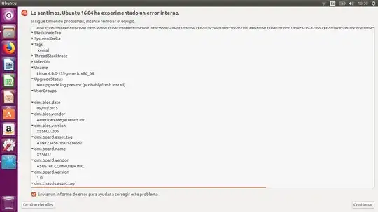

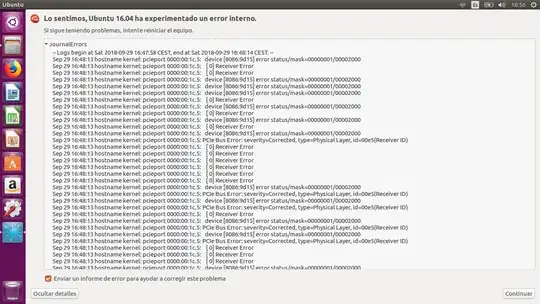

I'm trying to install Ubuntu 18.04 on my ASUS F556U laptop without success. I already asked other questions on the subject, thinking that the problems were by UEFI mode. Well surpassed that, I already discovered that the problem is of the laptop, a professional I assure to me that it can be problem of Targeta Grafica, is not compatible with Linux. Well, since I can not install 18.04 install 16.04 but when updating it is broken and there is an error in the screen that I can not distinguish well, which I show: PCIe Bus Error: severity = Corrected, type = Physical Layer, id

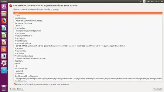

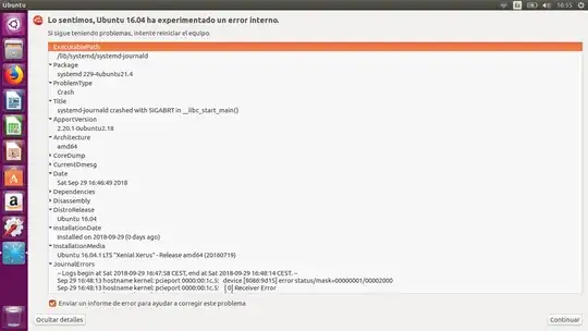

When installing 16.04 it works perfectly, but it notifies me of an internal error, to send to Ubuntu. The error I show you in a screenshot. I hope someone can help me, maybe there is already a question on the subject on this site, but maybe I did not know how to look for it. I've been with the problem for almost two months, and now I can not buy another laptop, if it does not work for Linux. I already tried other Linux distributions, and it gives me the same error. Now it gives me another problem, a message saying that I have little space in the root file system, only 924 MB, when I leave 150 GB. If you can give me an idea, thank you. I show you screenshots of the errors you asked me to send to Ubuntu

The partner @oldfred helped me with his comments, but ASUS does not give me support for UBUNTU, to be able to update the BIOS. I do not know if I am adding PCI = NOMSI correctly, because when I update, the error of the first image that I am attaching is shown on the screen. If you could help me, it is very frustrating to have a laptop with which I must work and not be able to install Ubuntu. Well, I think the reality is that Ubuntu is not installed, because Asus is giving me a lot of war.

Almost all systems need to have UEFI/BIOS updated to latest available from vendor. So first thing to check is if UEFI/BIOS is latest version from vendor. Normally there is only one version and it may say Windows. But Microsoft requires vendors to allow users to turn off UEFI Secure Boot. But even if UEFI Secure boot is on, Ubuntu should install. But proprietary drivers may require you to turn off Secure Boot.
Many Asus models need a boot parameter pci=nomsi. On initial boot you can manually add it to grub menu. But if a parameter is always required you will want to make it permanent by editing this and then updating grub.

Similar systems with issue: ASUS X540U pci=noaer instead of pci=nomsi and it also worked
