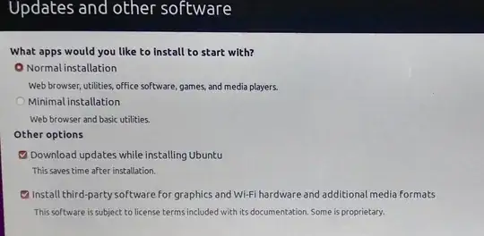

I have an Asus F556U series, 8G of RAM, and trying to install Ubuntu 18.04 from USB when I get to the part where it shows the image, the installation freezes. I've been half an hour now and continue as you see the image. Is there anything special I need to do to install Ubuntu on Asus? Thank you

I have managed to overcome all the problems that my Asus F556U offered me to install Ubuntu 18.04 and it was thanks to @oldfred which showed me the idea of updating the BIOS, and it shows in another question I did: How to install Ubuntu on ASUS F556U, JournalError error?
Seeing other examples and modifying GRUP, changing quiet spla\sh by pci=nomsi I managed not to freeze the installation and could complete it.
