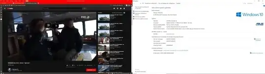

I'm trying to install ubuntu on my laptop. It's an asus. Here are the specs: specs I've desactivated the fast and secureboot. I use a cd to install ubuntu.(it works,my father installed it on his pc) But i have this error :
watchdog: BUG: soft lockup - CPU#4 stuck for 23s! [thermald:1424]
It keep sending this message with the different cpu numbers. Someone can help me find the origin of the issue ?
