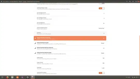

Install "dconf Editor" tool.
search with the keyword "sleep".

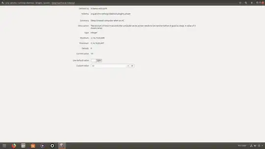

go to the filed "sleep-inactive-ac-timeout"
Give your preferred amount of time in seconds.

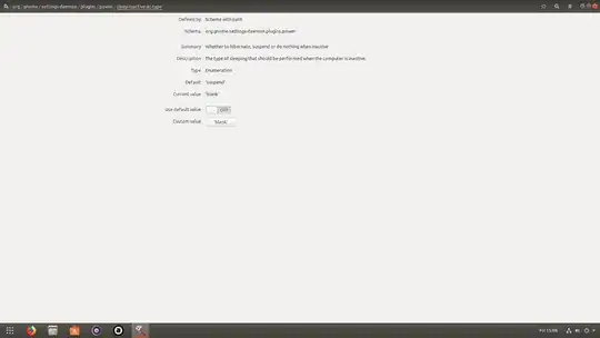

go to the filed "sleep-Inctive-ac-type" and choose the preferred value. (i have set it to blank)
same thing do it for "battery mode" also.
