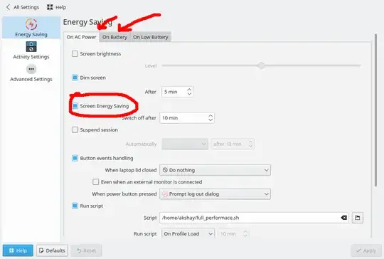

For KDE, it is much, much simpler:
Goto System Settings -> Power Management -> Energy Saving
It has three tabs: AC Power, On Battery, On Low Battery
For each you can choose: Screen Energy Saving (it is a chek box, you can enable disable it)
KDE Power Management (Energy Savings
Personally, I favour KDE, it works perfectly, and is easy to check if settings are set or not.
