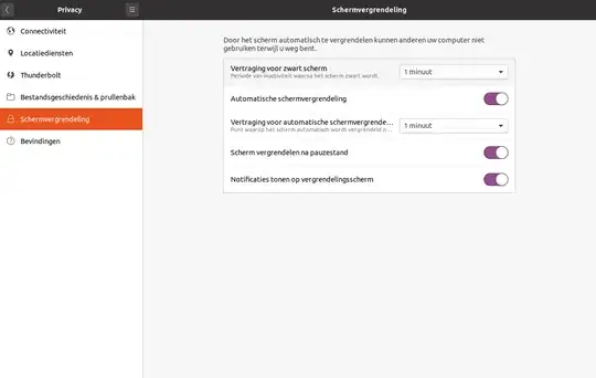

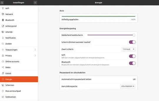

After upgrading to 20.04, my screen does not blanks after the given timeout. When I performed the upgrade, I got a notification of the upgrader that screen blanking would be disabled. After the upgrade, I think i set everything to enable it again, but it does not work apparently. Here are 2 screenshots of my settings: enter image description here enter image description here
Did I overlook some setting?
