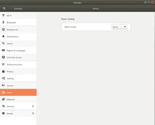

As the title, on my Settings > Power menu, there is no "Suspend & Power Button" option. So, I can't adjust the time of suspend/hibernate. Is there any answer of why? and how to solve this sistuation?
This is my captured image of Setting > Power menu

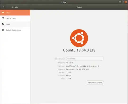

This is my captured image of Ubuntu version
