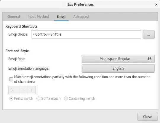

Just noticed this annoying emoji input ("Emoji Choice") popping up every time I press Ctrl+Shift+E in 18.04. I really need this shortcut to switch to the file explorer in Visual Studio Code but instead I only get the emoji input. Is there a way to disable this or at least change the shortcut? Don't want to change the VCS's shortcut because of this, I'm really used to it

Just a small hint: In case you don't find the IBus Preferences dialog, open a Terminal shell and type
ibus-setup
A dialog like this will appear on your screen:
- 119,640
- 511
Turned out it was the new ibus version that included the emoji package, I was able to change the shortcut in the ibus settings.
