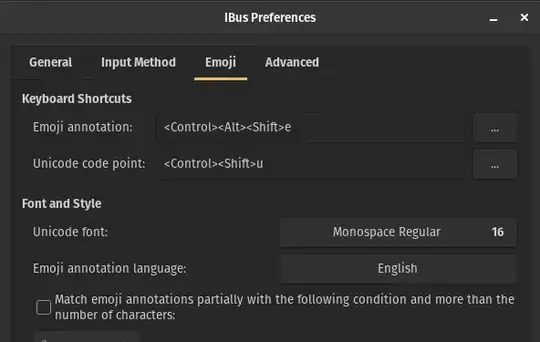

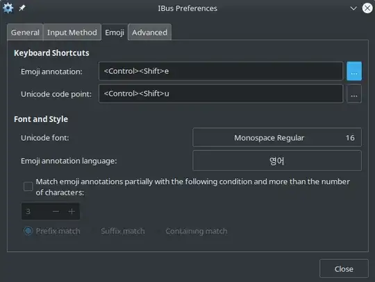

In terminal type ibus-setup, go to the Emoji tab, and delete/change the keybindings.
screenshot

Like kuceb answer but using CLI, changing to Ctrl + Shift + Super + e:
gsettings set org.freedesktop.ibus.panel.emoji hotkey $'[\'<Control><Super><Shift>e\']'

Open Ibus preferences in your launcher, visit the Emoji tab, then click the ... beside Emoji Annotation to either Delete or change the shortcut:
