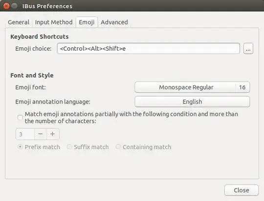

On needs to run ibus-setup and in the "Emoji" tab
IBus Preferences dialog box showing the Emoji tab
....change the shortcut (click on the three dots that are focused in the screenshot). I had to restart my computer after that so that the change would take effect (not sure how to restart IBUS).
