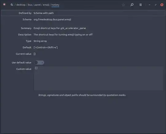

Some of the shortcuts is impossible to change with built-in system settings GUI. Most other system-wide shortcuts could be changed through dconf as described here.
  • Open Terminal (Alt+Ctrl+T by default)
  • sudo apt-get install dconf-editor
  • dconf-editor
  • Navigate to desktop.ibus.panel.emoji hotkey
  • Further toggle Use default value and change the shortcut to [] as in the image below:
Screenshot

Shortcut is introduced by ibus release 1.5.18.
Disable the shortcut key by altering the hotkey item:
gsettings set org.freedesktop.ibus.panel.emoji hotkey '[]'
Revert/Reset to factory defaults using:
gsettings reset org.freedesktop.ibus.panel.emoji hotkey
