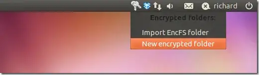

                                After installing, go to Applications –> System Tools –> Cryptkeeper.

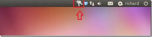

                                        Cryptkeeper will automatically attach itself to the top panel

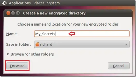

                     To create an encrypted protected folder, click on Cryptkeeper applet and select                                                                             ‘New encrypted folder’
                          Then type the folder name and where to save the folder and click ‘Forward’.

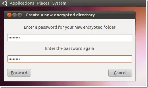

                                                              Type the password and click ‘Forward’.
                                                      The folder will be created and ready to be used.

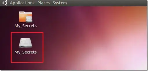

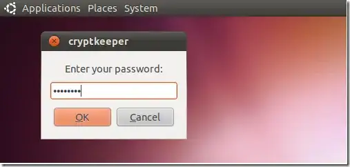

                   To access all encrypted folder, click on Cryptkeeper applet on the panel and select                                                                                                each folder.
                                                   Type the password before it is mounted to be accessed.

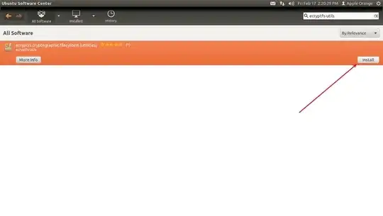

Search for and install ‘ecryptfs-utils’ in Ubuntu Software Center:

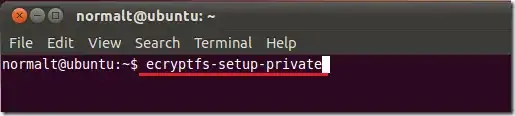

After installing, go to Applications –> Accessories –> Terminal and run the command below:
ecryptfs-setup-private
You’ll be prompted to type your login passphrase (password), and to create one for your private folder:

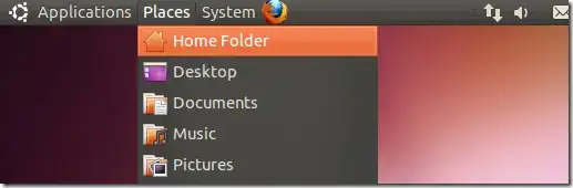

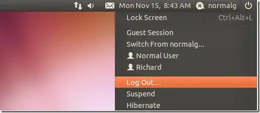

When you’re done creating your password, Log Out and Log back in:

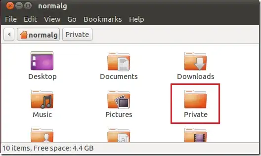

Next, go to Places –> Home Folder:

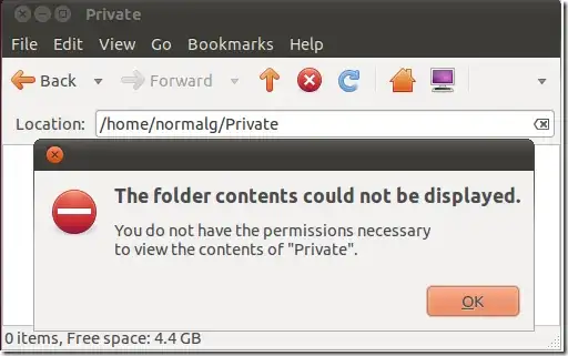

And new folder should be created in your home directory called ‘Private’. This folder in encrypted and password-protected. Move all your personal stuff into this folder to secure them:
Users without access to the folder will be denied:

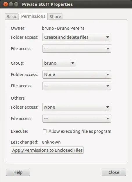

An easy and fast way to do so is using chmod to change the privileges for a file or folder.
Open a terminal and navigate to the place where your folder is, lets assume that the folder name is foo and that we are currently located where the folder is.
chmod 700 foo
will make foo only available for your eyes, its not encrypted (that is also possible) but only your user (and or a user with sudo privileges) can read or open that file / folder.
You can also do it graphically by right clicking on a file or folder and changing its permissions manually. In the example below you as owner have all privileges and you deny any other group or user from accessing, reading or modifying that file / folder

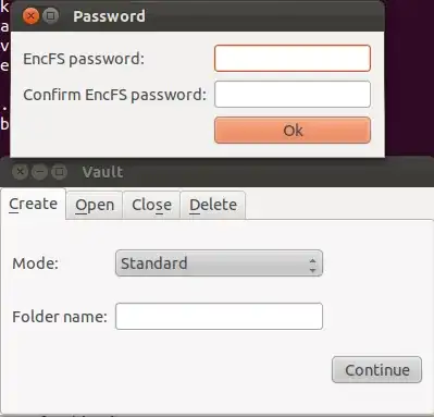

You can try Vault, recent project by an ubuntu-gr member (greek local community).
PPA:
sudo add-apt-repository ppa:vault/ppa
sudo apt-get update
sudo apt-get install vault
It's a gui utility for encfs (package in repositories). I quote the package description:
$ apt-cache show encfs
Package: encfs
Description-en: encrypted virtual filesystem
 EncFS integrates file system encryption into the Unix(TM) file system.
 Encrypted data is stored within the native file system, thus no
 fixed-size loopback image is required.
 EncFS uses the FUSE kernel driver and library as a backend.
Homepage: http://www.arg0.net/encfs
You create a mountpoint/folder which you can then close or delete. If you close it, you need a password to open it.

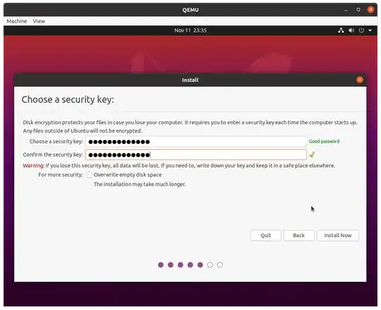

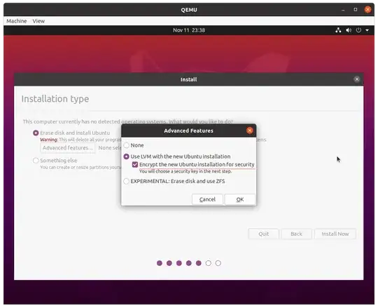

You click:
  • Erase disk and install Ubuntu
  • Advanced features
  • Use LVM with the new Ubuntu installation
  • Encrypt the new Ubuntu installation for security
screenshot

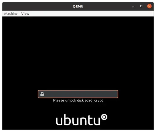

Then it asks you for a password on the next step:
screenshot
Now, every time you boot, the very first thing you see, (TODO before or after the bootloader?), is a password prompt:
screenshot
And after this, if you enter the correct password, it goes into a normal boot.

  └─sda6_crypt        253:0    0 1022.8G  0 crypt
    ├─vgubuntu-root   253:1    0 1021.8G  0 lvm   /
    └─vgubuntu-swap_1 253:2    0    976M  0 lvm   [SWAP]
so it appears that the second stage bootloader under /boot itself is not encrypted, but the root directory and swap are.
As mentioned at: https://help.ubuntu.com/community/Full_Disk_Encryption_Howto_2019 this opens you to the risk that an attacker would be able to compromise your machine by tampering with the boot folder, without your knowledge, and use that to later extract your decryption keys if you continue to use the machine.
Full disk encryption at install time (including /boot)
There doesn't seem to be an automated way of doing it as of 20.04, but hopefully it will get implemented sooner or later, some manual guides:
