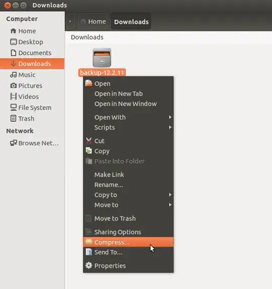

Right click on the file(s) or folder(s) and select Compress:

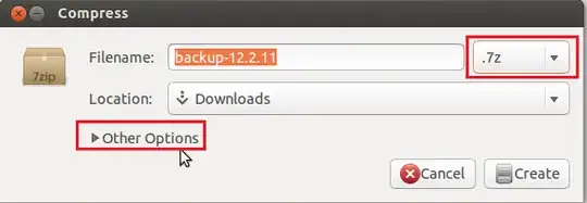

In the window that will appear, select a compression format (7z, zip, tar, etc.), then click Other Options:
Enter any password of your choice, check on "Encrypt the file list too", then click Create:

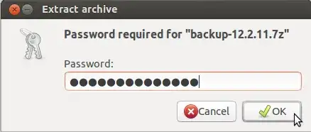

You have now compressed and password-protected your file/folder. No user can now extract the archive file unless he/she provides the correct password:
