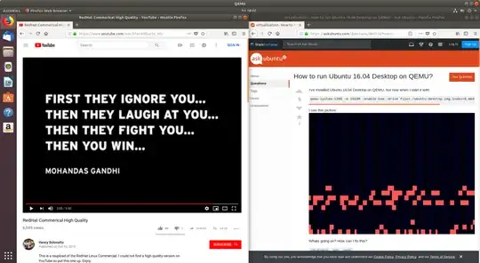

I've installed Ubuntu 16.04 Desktop on QEMU, but now when I start it with:
qemu-system-i386 -m 1024M -enable-kvm -drive file=./ubuntu-desktop.img,index=0,media=disk,format=raw

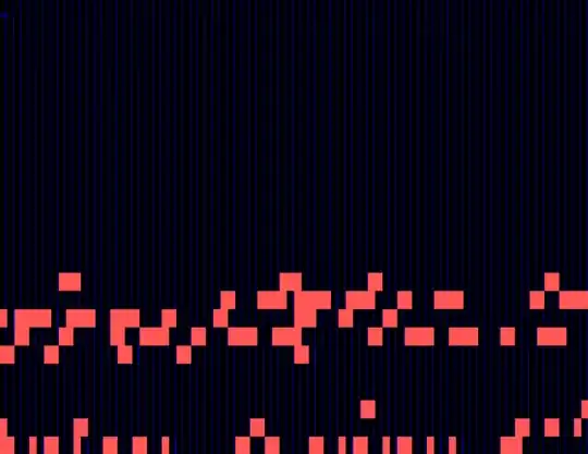

I see this picture: enter image description here
Whats going on? How can I fix this?

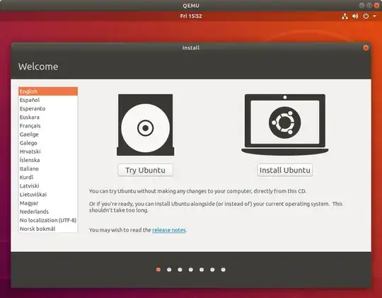

The installer looks like this:

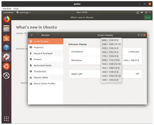

This setup has, by default, a funky system that automatically resizes the guest resolution to best fit the QEMU window size, you can see this if you do one of:
  • drag the window with the mouse
  • toggle fullscreen with Ctrl + Alt + F or or start QEMU with -full-screen

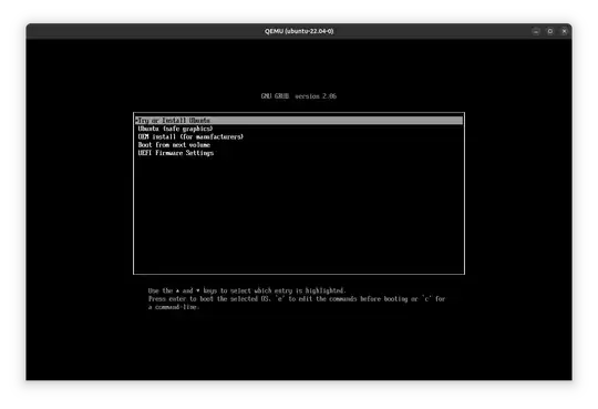

and this leaves us in the Ubuntu installer:

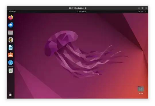

From there on I just next next next and wait for the installation to finish and after that it rebooted into the GUI:
