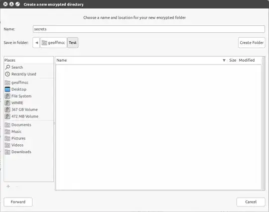

From there you will get a key icon in your top panel. Select New Encrypted Folder and you will get a popup. Fill out the name of the encrypted folder at the top, and choose a directory to keep it in. When done, press the forward button in the lower left.
Example of setting up - First Step

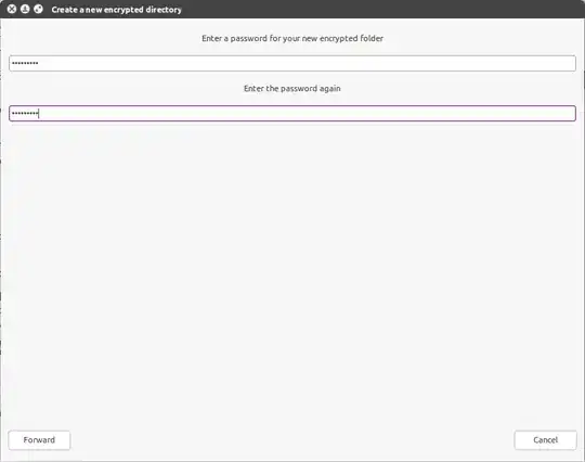

Now you are prompted for your password. After you fill out twice, again press the forward button in the lower left corner.
password

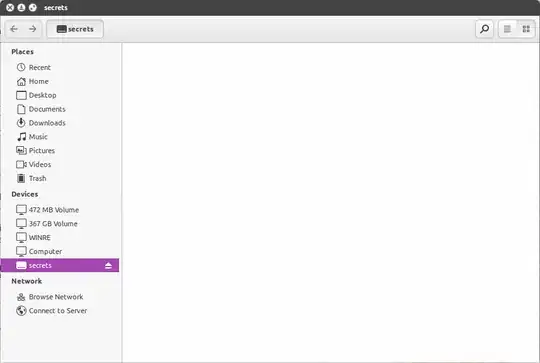

After a moment a new window will open and this is your encrypted directory.
encrypted directory

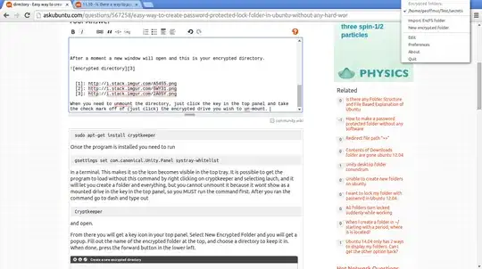

For some reason my screenshot tool would not capture a picture of the icon, but this is what the program looks like once you click on the key icon.
program
