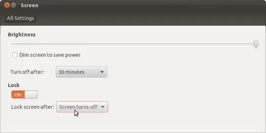

Actually, you just need to ensure that your screensaver passphrase is required on resume from suspend, and you'll be safe.
This will ensure that someone resuming your laptop from suspend will have to enter a password before they can get into the computer.
