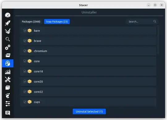

zx485
  • 2,865
To remove Snaps using a GUI application, install Stacer from Ubuntu Software.
There is an uninstaller option in the app which will list all your Snap Packages and you can individually select the ones you wish to remove after which you will be asked to input your password for authentication and the packages selected will be removed.
The application has many other features too which I find extremely useful and simple to use.
