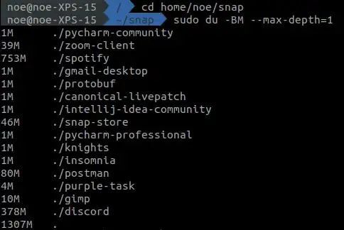

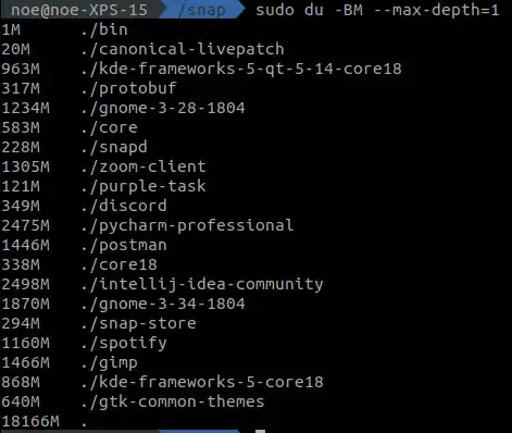

I think my snap folders in root and home are swapped. Indeed, according to the answer of this post, all the configuration files of my snaps should be in the snap folder stored in /home while there should only be mount points in the one stored in /root. However, it seems to be the other way round (18GB of memory used in root and 1.3GB in /home):
/snap hard drive usage
/home/{username}/snap hard drive usage
Q1: How can I swap these two folders? (I guess simply moving them won't work)

Indeed, according to the answer of this post, all the configuration files of my snaps should be in the snap folder stored in home while there should only be mount points in the one stored in root. However, it seems to be the other way round [...].
This point is correct, but you're neglecting the fact that du doesn't care that something is mounted there. You asked it to tell you how big the files are in a specific location, and it told you. Check the output of the mount command and you'll notice that nearly everything in the /snap directory is just a mount point. Everything else in there is just a symlink. What you're seeing is correct, don't worry! You don't want to swap anything.
