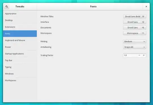

You may use (GNOME) Tweaks to adjust font sizes of various elements. First install Tweaks by running
sudo apt install gnome-tweaks
(or sudo apt install gnome-tweak-tool).
Then launch Tweaks and go to the Fonts section, you'll get the options to change font sizes.

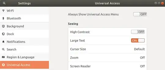

This helped me when I upgraded from 16.04 lts to 18.04 lts:
  1. open system settings
  2. select universal access
  3. turn on large text
screenshot

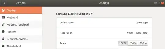

Some people suggest to just scale everything up going to Settings > Displays:
screenshot
