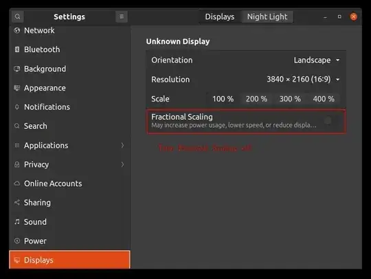

Fractional scaling
Avoid fractional scaling. enter image description here
This is expected. Fractional scaling in Xorg sessions works by rendering at a higher resolution than your screen(s). So that increases the likelihood of stuttering compared to integer scaling.
That specific issue will never be fixed because it's a required trade-off to get fractional scaling working in Xorg. HOWEVER, general performance will increase a lot in future versions like Ubuntu 20.10 so that hopefully will be enough to offset and eliminate all the problems you see.

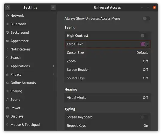

Font size
With high resolution 3840x2160, the default font can be too small. See How do I increase the font size in Ubuntu 18.04 LTS for a HDPI / 4K display?. I used Gnome Tweak scaling factor.
Apparently it also enable Setting > Universal access > Large text.
