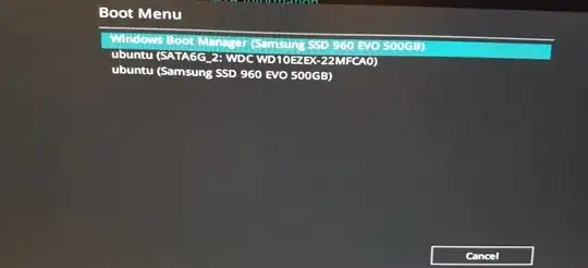

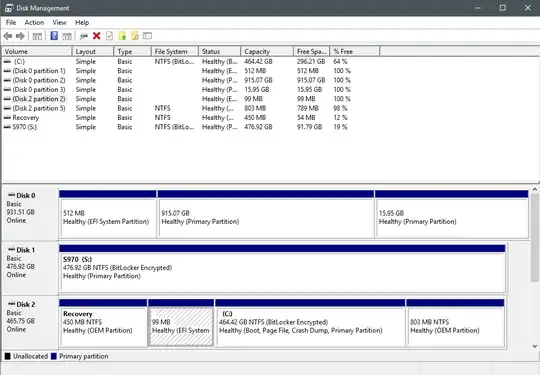

After all that, here is what my UEFI BIOS sees. So to me it looks like GRUB was installed on both disks. And looking at the partitions, I can see an EFI partition on the Windows SSD now.
UEFI Disks

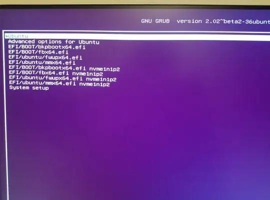

Both Ubuntu options load to the same GRUB screen, so I want to get rid of the one on the SSD.
GRUB
How do I remove the ubuntu (SATA6G_2: WDC WD10EZEX-22MFCA0) option? And is this possible without having to run any kind of boot repair programs? I don't want to risk losing my BitLocker encrypted Windows.
EDIT: Here is the output of sudo parted -l from Ubuntu side.
Model: ATA WDC WD10EZEX-22M (scsi)
Disk /dev/sda: 1000GB
Sector size (logical/physical): 512B/4096B
Partition Table: gpt
Disk Flags:
Number  Start   End     Size    File system     Name                  Flags
 1      1049kB  538MB   537MB   fat32           EFI System Partition  boot, esp
 2      538MB   983GB   983GB   ext4
 3      983GB   1000GB  17.1GB  linux-swap(v1)
Model: Linux device-mapper (crypt) (dm)
Disk /dev/mapper/cryptswap1: 17.1GB
Partition Table: loop
Disk Flags:
Number  Start  End     Size    File system     Flags
 1      0.00B  17.1GB  17.1GB  linux-swap(v1)
Model: NVMe Device (nvme)
Disk /dev/nvme0n1: 512GB
Sector size (logical/physical): 512B/512B
Disk Flags:
 1      17.4kB  16.8MB  16.8MB               Microsoft reserved partition  msftres
 2      16.8MB  512GB   512GB                Basic data partition          msftdata
Disk /dev/nvme1n1: 500GB
Disk Flags:
 1      1049kB  473MB  472MB   ntfs         Basic data partition          hidden, diag
 2      473MB   577MB  104MB   fat32        EFI system partition          boot, esp
 3      577MB   593MB  16.8MB               Microsoft reserved partition  msftres
 4      593MB   499GB  499GB                Basic data partition          msftdata
 5      499GB   500GB  842MB   ntfs                                       hidden, diag

Boot entry 2 has the same UID for SSD disk as boot entry 0 which is windows loader.
For example, 74ab4c2d-3660-4780-a9a1-f3cad2a533c0 matches entry 0 as well as entry 2.
Step-2.3:
Issue the following command to remove entry 2:
$ sudo efibootmgr -b 2 -B               # where 2 is the boot entry Boot0002.
Now the entry 2 has been removed.
Warning: Please select correct extraneous boot entry for removal. If you make a mistake, you may harm a needed bootloader.
Step-2.4:
To confirm the removal, just issue the following command:
$ sudo efibootmgr                   # issue this command to display boot entries
Whose output is as follows:
BootCurrent: 0001
Timeout: 1 seconds
BootOrder: 0001,0000
Boot0000* Windows Boot Manager
Boot0001* ubuntu
You can observe that only two entries are present rather than three.
Just see the entries marked with *.
Step-2.5:
Reboot the system and press del key and enter into BIOS setup screen.
Now you will find only two bootloaders viz., Windows boot loader and Ubuntu boot loader.
