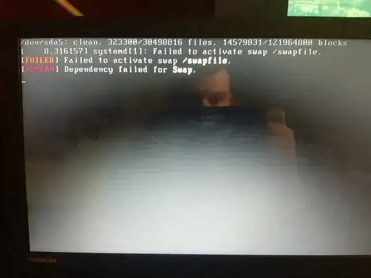

I tried doing this manuel : How to enable hibernate option in Ubuntu 20.04?
but now after the reboot I cant load the pc ,I get this eror : enter image description here

I am using hibernation on thinkpads, but it takes some steps before it works:
I do not use swap files. Never worked. So a dedicated swap partition is needed for these instructions. The size of the swap partition must be at least as large as your RAM
  1. After installing copy the uuid entry from fstab. It is represented as xxx below. The commands presume you are su or sudo...
  2. Create file /etc/initramfs-tools/conf.d/resume and add the line Resume=UUID=xxxx
  3. Execute update-initramfs -u
  4. In /etc/default/grub set GRUB_CMDLINE_LINUX="quiet splash resume=UUID=xxxx"
  5. Execute update-grub
  6. Change contents of/var/lib/polkit-1/localauthority/10-vendor.d/com.ubuntu.desktop.pkla:
[Re-enable hibernate by default in upower]
Identity=unix-user:*
Action=org.freedesktop.upower.hibernate
ResultActive=yes
[Re-enable hibernate by default in logind]
Identity=unix-user:* Action=org.freedesktop.login1.hibernate;org.freedesktop.login1.handle-hibernate-key;org.freedesktop.login1;org.freedesktop.login1.hibernate-multiple-sessions;org.freedesktop.login1.hibernate-ignore-inhibit
ResultActive=yes
Note: The "Disable hibernate" sections can be removed -or not
Reboot, then try: systemctl hibernate
If that works, you can change your settings (e.g. Lid close to hibernation).
